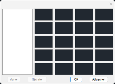

In AutoCAD 2026 an very old Application using lisp uses IconMenu-Function from menucmd.
This menu is available in an partial loaded cuix
Calling (meucmd "I=IFPWS-NAPF)(menucmd "I=*)
shows an empty Icon Menu.
Specified "functions" from menu are not called or displayed.
Are there changes between last releases (function is running in AC 2012) or what I'm doing wrong?

Justus_Wille
SLB is existing in Supportpath

Justus_Wille
Thanks for your support. The reason was a differend MenuContext (<MenuGroup Name="xxx">). Call right syntax with:
(menucmd "I=xxx.MenuName")(menucmd "I=*") -> and it works.
