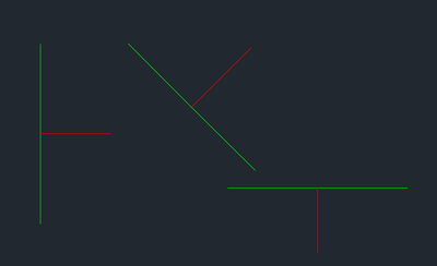

hythamthelove
Your lisp is so good, can this lisp be adjusted to move lines to the nearest vertex of other line like this
The green lines to be moved to the nearest vertex of the red line
Message 50 of 51
_Tharwat
Yes it is doable and I can write it for you if you can pay for it.
