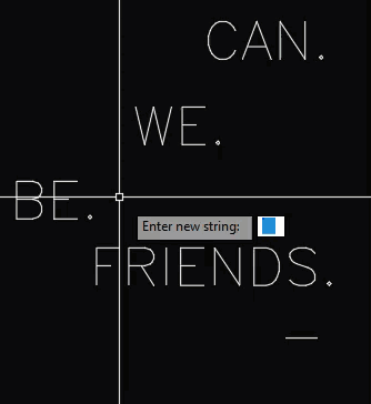

THIS should do what you want as well .. not MTEXT though.

Here's one that will do mtext too .. although the last character in an mtext string could be part of formatting so results could get a bit wonky.
