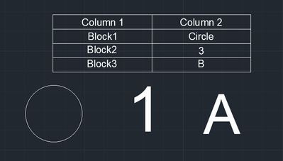

Hi Lisp experts, I needed some help regarding my project.
I want to run a specific lisp that can change the visibility state of a block which is stated on a Acad table (soon to be from Datalink).
Explanation:
Column 1 will be the name of the block
Column 2 will be the name of the visibility state to change to.

check the following. sets given visibility state 'Visibility1'.
