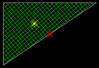

Something to consider....  If the Hatches are always rectangular areas [as they are in @jaimuthu's image], or other biaxially symmetrical shapes, it doesn't matter, but if not:
In this kind of situation, the approach of Zooming to the Hatch OBject and then using the center of the view for the Leader arrowhead will give you the red location.
Using GCEN Object Snap on the perimeter Polyline, or taking the Centroid VLA property of a Region made from it, or taking the mathematical average of the three corners [which for a simple shape like this can be drawn directly from the Hatch pattern itself], will give you the yellow location, which I would find preferable for the arrowhead.
EDIT:  In fact, with the Zoom-to-OBject approach, you can get that red location that's actually outside the Hatch, with for example a shape like this:
That yellow is from GCEN Osnap.  The Centroid is very slightly different from that.  The average of corners would be the same as above.
Kent Cooper, AIA
