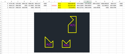

Thank you for your reply, I mean can you modifie your code at message 24, I need export have text inside polyline and area polyline (like picture) can you help me, please, very thank you!!

Thank you for your reply, text inside Polyline just normal text, any high, any text,only have one text and polyline is closed, can you help me to modifie your lisp code have more 2 columns text inside polyline and area polyline, same my picture, very thank you!

Thank you, before when use Kent1Cooper 's lisp code at message 24, by select all polyline it will export length of all segments, now I need more 2 columns, text inside polyline and area polyline, just one text inside (not mtext) and all polyline is closed (yellow colums in my picture), please help me, thank you very much!
