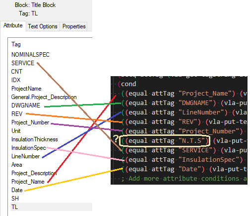

zirudezirude
Here is the ATT background of the title block
Message 14 of 16
paullimapa
Now that you've provided me with the Title Block showing the Attributes I can properly set the Attribute Tag names.
Typically Attribute Tag names are created in all in caps. But in your case they weren't. So I just revised the code so that the Attribute Tags are as you've originally inputted them in the code. Now when the code runs all the Attribute values update. If you do add more, just again match the case as you have them:
FYI: Your Title Block currently does NOT have an Attribute TAG matching N.T.S.
Instead this is currently placed in the Block as Text:

zirudezirude
@paullimapa you're brilliant Guy thanks a lot 👍
