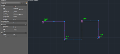

Message 4 of 36
jlicerioAQQLC
Trying to make a line that is continuous from point to point it is for wire from block to block.

jlicerioAQQLC
What I'm trying to get is a lisp code that is continuous pline this one I'm using only goes from point a to point b and then I have to make a new line.
Message 13 of 36
jlicerioAQQLC
These are 3 separate plines that were made with the script. Im trying to make it one pline from block to block that can continue.
Message 14 of 36
jlicerioAQQLC
Had to join it manualy here.

Message 16 of 36
jlicerioAQQLC
this is the feature I'm trying to obtain. But I want to add more customization.

jlicerioAQQLC
The aesthetics isn't a big problem it is that the line has to be joined to get the length of the wire.
Message 20 of 36
ronjonp
As mentioned before, why not use  a polyline ? Code is not needed.
Maybe THIS can help you with your attribute numbering.
