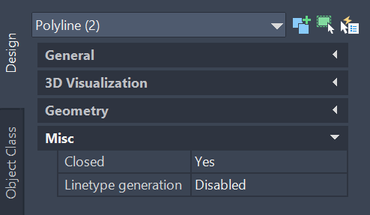

@leekennewell ,
Use APPLOAD to load the Arc2seg.lsp.
Select the polyline with the arcs (this will make arcs to line segments).
If not closed, select Yes in the PROPERTIES, this will allow the WIPEOUT to work.
