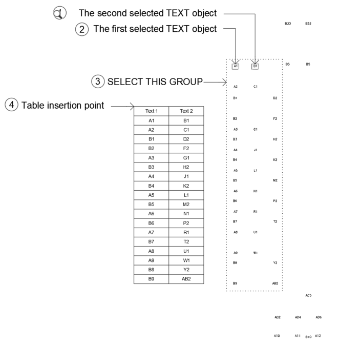

Good Day everyone!
I have this idea in mind that need everyone's help.
Is a LISP routine possible to make a selected text placed automatically in a table
Arrangement:
If Text 1 (blue text) and Text 2 (green text) was selected respectively, then at the end of the program, it can generate a table where all the selected text paste in it but it need to do by pairs.
I have attached the cad file for your reference, Please observe that the text in each box are transferred to the table by pairs.  Thank you

If the rectangle is always there and the text is always two colours you could just select the rectangles and from that get both text items.
I am not one of the robots you're looking for

Hi dlanorh,
Thank you. The rectangle is not present during actual, I just put in to show the grouping of each pair (consists of two text only per grouping. Imagine that the table is not yet present and could be automatically created after the selection of text made.

Please try this may need a bit of fine tuning but should be close. Needs Multi radio buttons.lsp

Hi Sea.Haven,
Thank you for below code. I tested and so far it works but i have difficulty in running the program and I can't figure out the main command please help me on this. I need to app load the lisp every time I run the program in order to work. Thank you.
Message 6 of 25
Sea-Haven
If you change AH:txt2tbl to c:whatyouwant in the two locations in the code then you can run again without loading by typing whatyouwant.
The need for horizontal and vertical was to do simply, there is  a lot more in it to just pick in groups and work out vertical or horizontal.

Thank you but does't work on my approach:
I'm using appload command from Autocad to load the LISP, then none of the 3 c:below work highlighted in blue.
Can you make it that all the blue text are always at text1 column and the green one in text2 column regardless of the arrangement of the text(vertical/horzontal) but base on the color. Thank you to consider this suggestion.

In response to your email if you look at code after this (if (= ans "V") it checks for ver or hor text in sorting out the text order if you make 4 choices Left Right Top Bot then this will imply the order you can use say left on the right if you swapped the right hand column to look like left. It will mean a bit extra coding have to do normal work now.

Just a couple of comments. If you read the posts again you will see that the OP only put boxes around the text to clarify in reality they do not exist so using ssget "wp" can not be used.
There is also a bit of a stagger in the text in a couple of locations hence a wp may grab something else. In testing on left text did in two goes the ssget. I just plan to add the 4 variations for the moment a ultimate hint paid for would work out whats going on.

I tried the program and run several trials, there are things that I've noticed like below:
1. From what the reference LWPOLYLINE referring to? because the rectangle is will not be there in actual.
1. The number of rows varies (on what part of the program defines this?)
2. What is the arrangement of the text? How is the program makes the order?
3. How's the data of column A & column B been collected in the model space, what is the limitation here?
Thank you in advance.

Working on L R T B at moment hang in there. It will not recognise Green text etc but allows the swapping of the columns / rows as this is more a universal answer for any one else wanting to use.

I have redone the code to use two picks of the text makes life easier to code.

pbejse
@Tolearnlisp wrote:
thank you @pbejse,
... there are things that I've noticed, why is there two 1.  🙂
Here's what we're going to do:
  1. There would be no selection for LWPOLYLINE [ Not existing as per posts ]
  2. Now it would depend on your selection
  3. The order would always be LEFT to RIGHT or TOP to BOTTOM
  4. We will remove the ssget filter "_X"
The first two prompts will determine the order on the table. [ Horizontal or Vertical ]
Command: TABLETHISTEXTTHINGY
Select First column reference TEXT ( select the TEXT object that will be on the first column )
Select Second column reference TEXT ( select the TEXT object that will be on the second column )
Select objects ( select the TEXT objects that you want to be included on the table )
(defun c:TablethisTextThingy ( /  _DXF _isValidSelection _firstColumnText _SecondColumnText

Message 16 of 25
pbejse
Select First column reference TEXT [ The layer of this selected TEXT will be the first column value ]
Select Second column reference TEXT [ The layer of this selected TEXT will be the second column value ]
Select objects:  [ refer to image ]
Specify first corner: Specify opposite corner: 34 found
Pick point for Table:

Message 20 of 25
pbejse
@Tolearnlisp wrote:
Hi @pbejse ,
Thank you for the below code I appreciated the instruction you have provided.
Is it possible to make the text  order depend on the direction of how you will select the texts instead of just Top to Bottom and Left to right only. Thank you in advance.
So you did see the post.
The selection order won't be a factor on this version, the program will compare the collected list with the two selected text and use that as the first row for the table.
Select First column reference TEXT [ as the reference for the first column ]
Select Second column reference TEXT [ as the reference for the second column ]
Select objects: Specify opposite corner: 36 found [ Note that this should be an even number ]
Select objects: [ Enter to end selection ]
As before:table this.PNG
HTH
