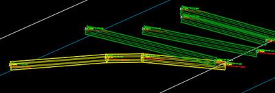

I am a surveyor at a pipe construction company.
The preliminary design requires data from pipeline traces of other companies that are already in the ground with their pipeline traces
Test trenches must be dug for this purpose.
The engineering firm wants this data to be supplied in autocad solids 3D. With the pipe data in the layer name.
The work process for this is now:
Create layer name. Place circle with diameter pipe on 3D polyline. Apply command sweep along path. Then I still have to move the solid because the top of the pipes have been measured.
This must be done manually for each pipe. Sometimes I'm busy for days.
Isn't there an autocad lisp routine that can automate this work??
It would be nice if this lisp could retrieve the diameter from, say, the layer name.

ВeekeeCZ
The start drawing does not include any 3dpolylines. Do you draw them manually (it could be part of the routine), or do you have list of points that are part of one pipeline?
Message 7 of 49
LukasA-HAK
This is how I receive the data from the GPS device.
I have to draw the 3d polyline manually.
Message 8 of 49

To be defined into a command name, yes -- it's the steps involved to do what they were asking, which can be done independent of "wrapping" them into a command name.  That's easily added, when the steps are determined to be what's wanted.  BUT FIRST:
Is your idea that a routine would find all the appropriate pairs to stretch pipes between?  Or would you go around and pick them?  If the routine is supposed to find them, how would it know which ones go together?
And what about the objects that do not extend between two Blocks as most do [what I changed to red here, viewing in 3D]?
What determines their lengths, and the directions they run?
You also have some that have a Block at only one end [magenta here]:
Again, what determines their lengths, and the directions they run?
And most are single-run pieces between two Blocks, but then there's at least one multi-segment one [yellow]:
What determines that situation, rather than [for example] two singles without the middle segment?
I don't see anything reliable about Attribute values to distinguish things that are handled differently, but maybe there's something I'm not noticing.

I should explain this.
Sometimes the direction of a cable trace is known because they run parallel to the road. But we don't know where it is. Because it is sometimes difficult to measure multiple points on a pipe or cable, you sometimes only have 1 point. But this can be solved by measuring at least 2 points by using a trick while measuring.

I would probably tend to do two routines.
The first will draw a 3dpolylines following point numbering and break by (layer/pipe)types.
Then must the user step in and fix it - break it where two different pipes of same type are in sequence.. and other things mentioned by Kent.
The second  routine simply converts 3dpylies to solids.

Kent1Cooper
@LukasA-HAK wrote:
.... That the program recognizes consecutive points. For example from 110,111,112. And a new series: 120,121,122,123.....
More criteria would be needed.  You have, for example, an area of Blocks with green Attribute values lb2023-01-09-143 through 154 inclusive.  151 through 154 are a three-segment result [yellow in my previous Reply], but the rest are all one-segment pairs.  How could a routine differentiate?  Why are not 151-152 a pair, and 153-154 another pair?  If there were gaps in the numbers, and only adjacent numbers would be connected, I could kind of imagine a way to do it.
The single-run pairs in that area all go from one with a red Attribute value ending in -d50mm to one ending in -d50mmmof, but in the case of the 3-segment one, from -d50mm through -d50mmmf and -d50mmmof and ending on another -d50mm.  What's a routine to think, if -d50mm is the start for most, but both the start and end of this one, and -d50mmmof is the end for most, but an intermediate within this one?
And the question remains about lengths and directions of those connected to only one Block, with the additional question of why some have their one Block in the middle of their length, and some at one end.
Etc., etc.

ВeekeeCZ
The first part. It draws polylines.
