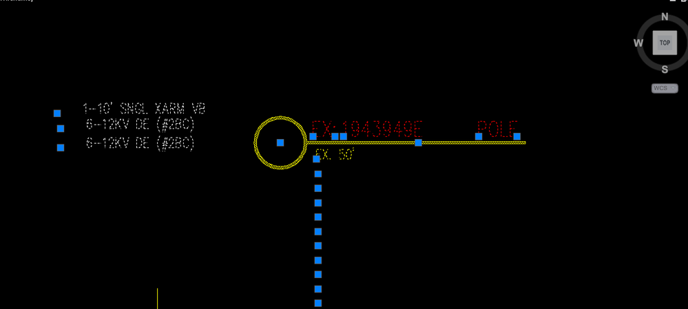

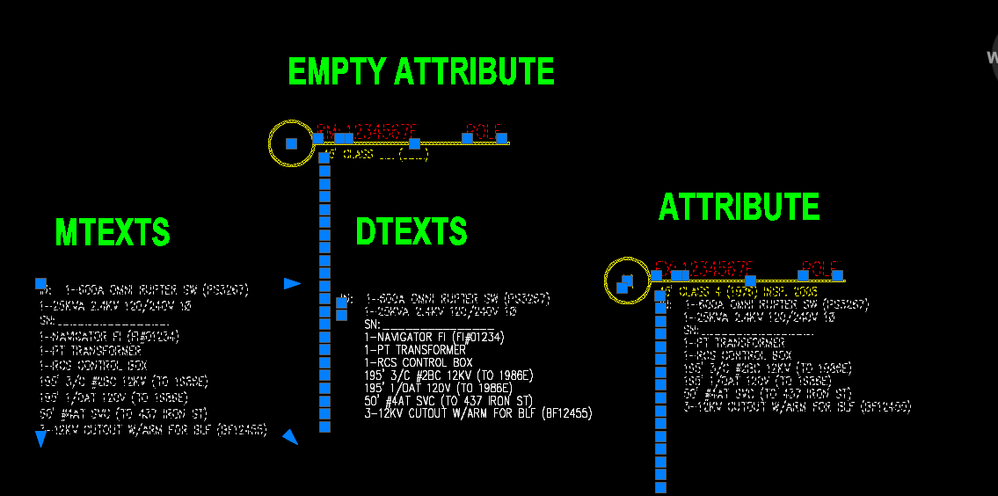

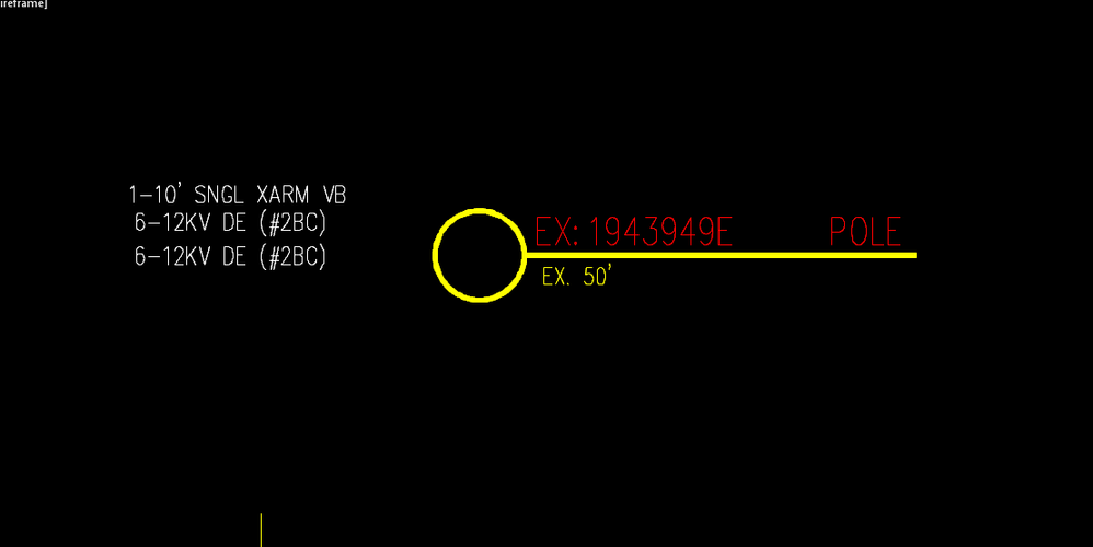

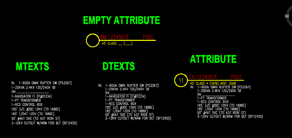

Sorry my explanation wasn't so detailed.
Here is what I need
As you can see there're mtext, texts and texts inside the block attribute respectively.
The mtext is what we get when we first start a new job.
Then we explode the mtext to individual text lines.
Our job is to insert the texts into the attributes and I'm wondering if there's a lisp that can add those texts to an empty attribute.
Thank you so much for your reply.
