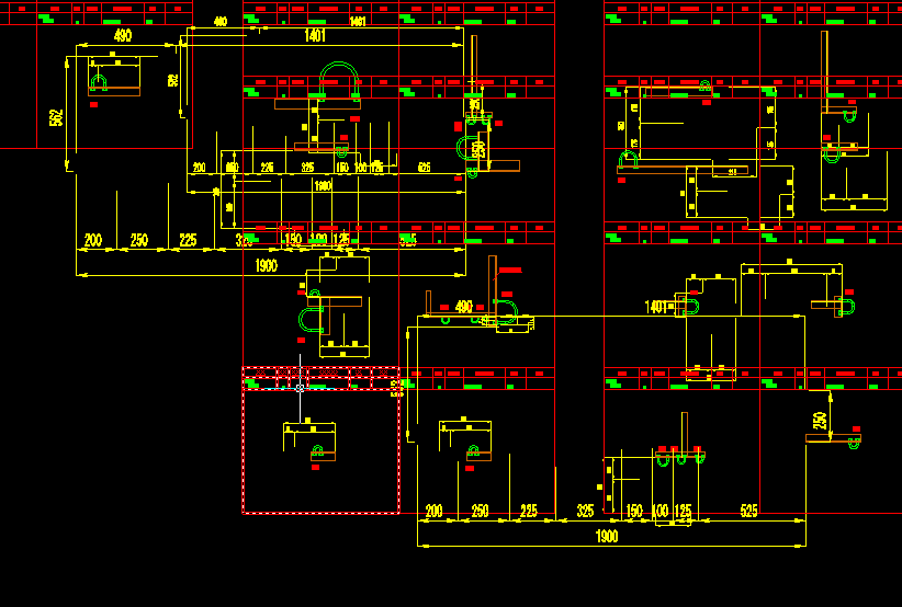

Message 4 of 16
Message 5 of 16
I'm gonna make like this,,,,,
Message 6 of 16
Kent1Cooper
Welcome to these Forums.
It's not clear to me what your purpose is.  But I will guess that your code is giving the result in the image in Post 3, but you want it to be like the image in Post 4 instead.
If that is true, apart from the difference that Post 4 has white rectangles that are not in Post 3, it looks like the problem is in the positions of some of the pieces that do not align with the others.  Do you have any running Object Snap modes on?  That's always the first question when things happen in a different place than you expect, and it looks to me as though some of the Blocks in Post 3 are in positions that might be from their insertion points Snapping to something in the corner of the previous Block.  You can have the code turn Object Snap off, either with (command "_.osnap" "_off") or (setvar 'osmode 0), but if you do that, you should probably also save its value first and reset it later.  In a situation like this, with only one place in a command that calls for a point that Object Snap could apply to, it's easier just to put "_none" before the insertion point in the Insert command.

But I found ether problem with block copy as photo.
So i hope when insert RENAME & BLOCK shoud be done bofore align.
Message 9 of 16
