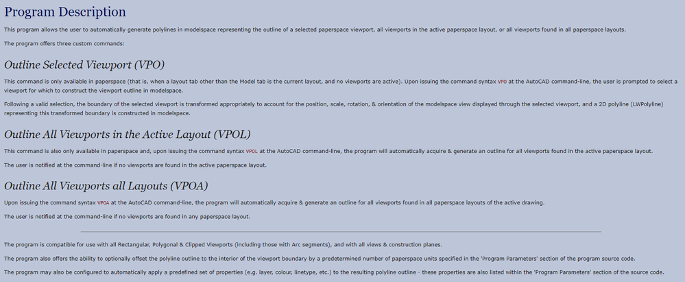

Hello everyoane.
Can someone help me with a lisp routine for drawing the border of viewport from layout to model space ?
If it can be done, I want to use it for all layouts at once.

TomBeauford
Try this code by Jimmy Bergmark: https://jtbworld.com/autocad-vp-outline-lsp
Also works with polygonal or clipped viewports. If a viewport's model space is active it automatically draws the outline in model space for that viewport, if in paper space you have to select which viewport to draw the model space boundary in. Works with twisted views in viewports as well.

constantin_dragoiu
big thanks!
