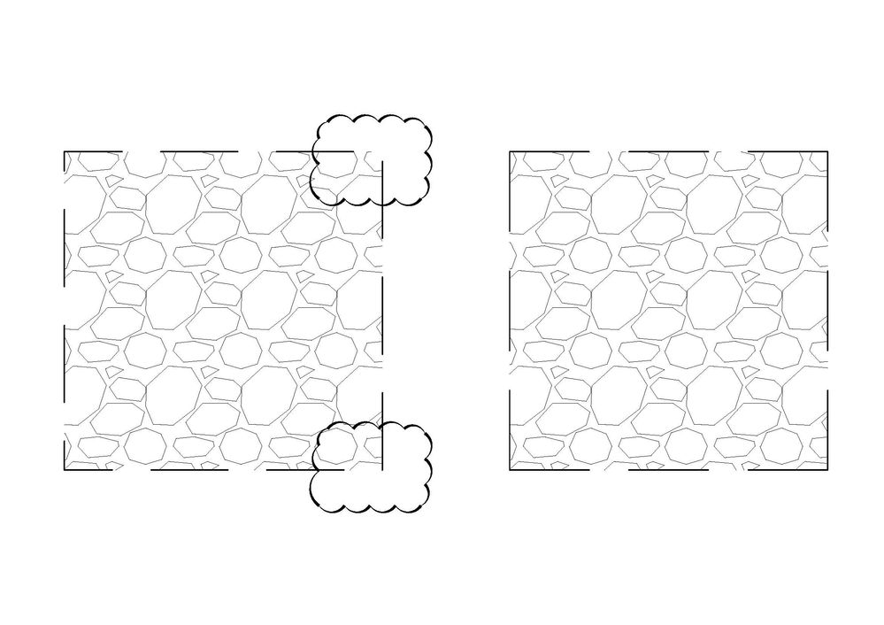

THANK YOU SO MUCH  FOR YOUR GREAT HELP.
Just I need a solution for the attached photo for the difference between two rectangles the one on the right was created by lisp, the other one on the left was created by command rectangleAEC-STANDARD-2020-Model.jpg
Message 14 of 21
hak_vz
Two different dashed line representations, depending on linetype generation turned on or off (0 or 1).
If linetype generation is turned on dashes are created so they don't break or restart at edges or vertexes.
In may code I have set it on, just to show you possible option.

I SOLVED IT (LINETYPE GENERATION 0)

For some reason the RECTANG command always makes a Polyline with linetype generation disabled, even when the current PLINEGEN setting is to make Polylines with it enabled.  So you could just omit the:
  (vlax-put eo 'LinetypeGeneration 1)
line entirely, rather than change the 1 to 0.
