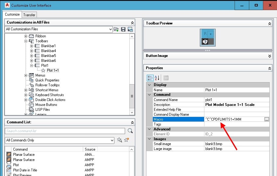

I'm having a problem with a LISP routine for printing to a pdf file.  I have the LISP working as desired - but only if I type the command into the command prompt.  What I would like to do is run the command from a button on the ribbon.  But when I do that, the LISP gets hung up on the step where it saves the file to a folder.  Can anyone tell me what am I doing wrong?  I don't understand why the same command works differently when entered command line vs. button.  Attached is my lisp file.

Message 9 of 16
Scottu2
I loaded your Lisp and added a macro to my toolbar.
It works for me, even with the =. (Autocad 2019)
The filename does not match,  the command string is off by one line.
Perhaps the plot string keystrokes where created while in paper space?
If the menu macro is using lisp commands to load the lisp first then check that code again.
Message 10 of 16
Sea-Haven
Message 11 of 16
tims79
The arrow you made pointing to the filename not matching - that is the problem. Something is going wrong at that point - but ONLY when I run the command from a button macro. If I type the command in it works perfectly.
The macro is simply the same command as I am typing manually, not loading a lisp first. The lisp is already loaded, verified by the fact that it works manually.
Is there some setting related to macros and the writing of files/directories? Security or permission setting? I am at a loss.

Scottu2
Hi Tim79,
When it did my test is was using the tool bar, it see that the ribbon is used here.
Compare the plot command results. See attached screen shot.
Message 14 of 16
tims79
Scott
Obviously, I noticed the different results.  That is what I don't understand and my whole reason for posting here.
You seem to be onto something with the toolbar vs ribbon, though.  It works correctly when launched from a toolbar button.  So it looks like the problem is with the ribbon interface.  That is good enough for me, I will just make a toolbar with the buttons I need.  Screw the ribbon!
