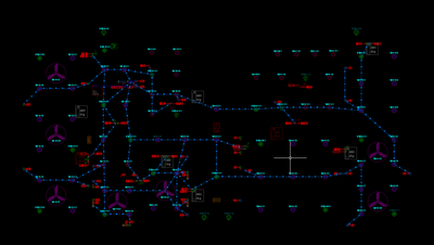

I am working on electrical conducting.
I used a line to connect the circuits. As as a result there are multiple overlapping line.
Is there a Lisp which could place a number near the overlapping line showing number of line operlapping.
Or a little advance if it can replace those lines with a numbered line type.
I am attaching a image for better understanding:
Option 1:
Advance option2:

too complex:

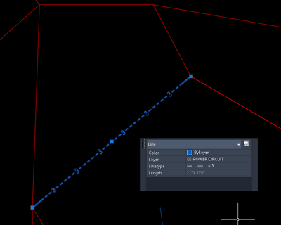

I have the following observation:
The code should be able to ask the user to select the bunch of lines to work on. So it can be user-friendly to other Cad users also.
This is what I think. However, I am still a beginner in Lisp coding .So don't know the practicality it is possible.

I tested it out and it looks amazing.
Few observation :
Some lines are not changed which are overlapped as the code version 2.0  was not able to change them.
But in Version 1.0 the code placed a number there.
