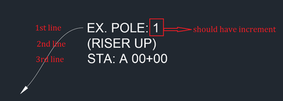

I am trying to insert multileader with 2 to 3 lines of mtext.
The first line is where the increment will happen
Second line: no increment
Third line: no increment
What I wanted is when I enable the LISP I can put the mleader anywhere and it automatically increments the number I wanted.
Here is a snip so you can see why the are 3 lines in the mleader:

I already have a lisp file where you can insert just one line of the mleader. But I also need the 2nd and third line for my mleader to be complete. Thanks!
 *lisp file is not mine. just copied it from this community as well

Try this. It adds no additional chars but paragraph marks
(vl-load-com)
(defun c:IncAt ( / 1line 2line 3line startNos p1 p2)
  (if (and
	(setq 1line (getstring T "\n1st line text: " ))
	(setq startNos (getint "\nEnter Start number: "))
	(setq 2line (getstring T "\n2nd line text: " ))
	(setq 3line (getstring T "\n3rd line text: " ))
    (while (and
	     (setq p1 (getpoint "\nPick target point"))
	     (setq p2 (getpoint p1 "\nText Location"))
      (command "_Mleader" "_non" (trans p1 1 0) "_non" (trans p2 1 0) "")
      (vla-put-textstring (vlax-ename->vla-object (entlast))
	(strcat 1line (itoa startNos) "\\P" 2line (if (= "" 3line) "" (strcat "\\P" 3line))))
      (setq startNos (1+ startNos)))
  (princ)
rcrieza
It totally works. Thanks!
