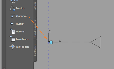

Message 5 of 12
tramber
This Dynamic block ?
I(*) then click and ENTER, ENTER, etc...
* stands for Classicinsert...

tramber
*^c^c_insert;"truc";\;;;
I put that macro in a button and it's terribly efficient. "Truc" is the name of the block (I put "Truc" and not Truc(*), in case, better habit since a name can contain spaces)
Escape to end.
*Thing 🙂
