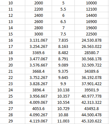

rafael.bizarro
Now i m having some issues with "." and "," from the data on the excel.
Some values "." is representing 000 separator and others "." represent ",".
Message 20 of 28
Kent1Cooper
Is there a setting in AutoCAD to report numbers without any thousands separators?
Kent Cooper, AIA
