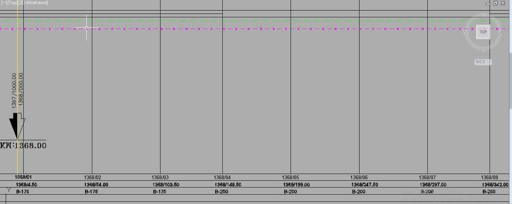

I have a requirement of finding the distance of multiple parallel lines from a single baseline.
I want LISP that will allow me to select the baseline(from which I need the distance of other lines) and lines for which I need distance. Here in the image below, the yellow line is the baseline and I need distance for all other lines from the yellow line.
If anyone has worked on this before, kindly help me out.

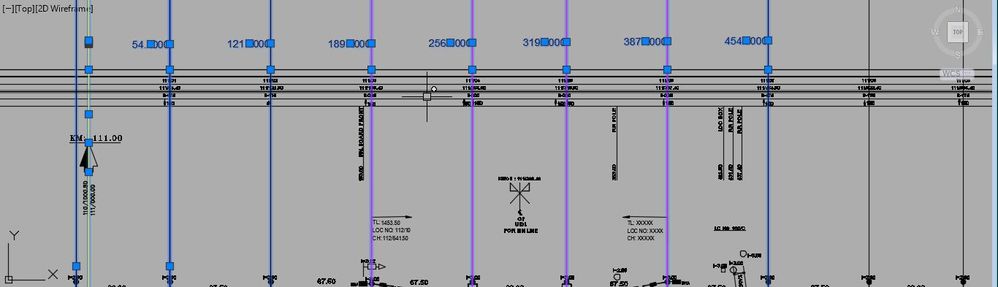

jaggisingh003
see this image.....
I have to write the distance from baseline at the specified place. like this image..
Message 9 of 15
jaggisingh003
I don't use ordinate dimensions. I am using baseline dimension for this like the image below...
baseline dimensionsbaseline dimensions Remove extension lines in dimension style.

jaggisingh003
see this
Message 14 of 15
Moshe-A
Ok i see now what you mean.
here is AutoDB command to do what you want
first you be asked to specify the 1st dimension line point: you need to pick the 1st point to the left of your base line. than pick the 2nd point to the right (turn ortho on) over the last line
the lisp will select all lines (only lines and if there are other lines remove them) by "Fence"
than the dimensions will be drawn
improve your dimension style so the outcome will be more readable.
if this suits you, mark it as solusion.
enjoy
moshe
