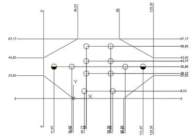

All the vertical dimensions have wrong type (should be Y axis)
I have added a line that converts all ordinate dimensions to annotative and it now uses current annotative scale that you set before you use a AUTODIM.
In my case dims are not associative since they are generated from points and are not connected to object
Coordinates y are different but result shown is correct since  In my code I exploit only x coord that is defined by a direction of bounding box segment, that is either horizontal or vertical.
Before command starts it will change ucs to world.

many thanks for your help and inspiration. I tested now in a pure Autocad, it works. But not so good in Autocad Mechanical - the vertical dimensions (Y axis) are stil head down. Maybe thiis will be explained over time.
Your help showed me the way, thank you very much

hak_vz
@avinash00002002
Try attached lisp to auto dimension "baseplate" i.e closed polyline with straight line edges  and circles (holes) inside. If you need to dimension baseplate with circular edges, open new post.

Hi!
Please see my drawing with ellipse marked in red. the dimension are not coming on the dimension line as other dimensions.
another thing is if two block in one line in horizontal or vertical all dimensions are duplicated. please see overlapping  dimensions.
I tried to remove duplicate dimensions and horizontal dimensions is on above line but not succeed.

@avinash00002002
My code is created to work with decimal units and it then creates correct result.
In case when you have more then one block along same line you'll receive duplicate dimensions. Simply delete what is duplicate, and transfer dimension line to opposite side if needed. It's complicate to code in all possible situations.
Unfortunately settings that you use in your drawing, are responsible for result you receive, used dim style and similar. You have measurement scale factor set to 4 and similar.
