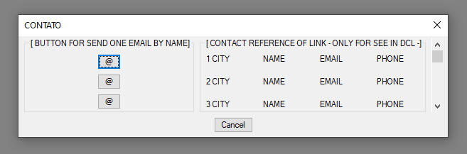

rolisonfelipe
;;;; dcl
EXECUTAR_EMAIL : dialog
{label = "CONTATO";
:row{
:row {
:row{
: boxed_column{ label="[ BUTTON FOR SEND ONE EMAIL BY NAME]";
: button {label = "@" ; key = "LINK01";fixed_width=true;width=0;height = 1;alignment=centered;}
: button {label = "@" ; key = "LINK02";fixed_width=true;width=0;height = 1;alignment=centered;}
: button {label = "@" ; key = "LINK03";fixed_width=true;width=0;height = 1;alignment=centered;}
:row{
: boxed_column{ label="[ CONTACT REFERENCE OF LINK - ONLY FOR SEE IN DCL -]";
: text {value= "1 CITY NAME EMAIL PHONE ";width=50;alignment=left;}
: text {value= "2 CITY NAME EMAIL PHONE ";width=50;alignment=left;}
: text {value= "3 CITY NAME EMAIL PHONE ";width=50;alignment=left;}
:column{
: slider {layout = vertical ;key = "myslider" ;max_value = 5;min_value = 0;value = "5";big_increment = 2;alignment = right;}
cancel_button;
;;;LSP
(DEFUN C:EXECUTAR_EMAIL ()
(setq ARQ_DCL (load_dialog "STANDARD-MENU") )
(new_dialog "EXECUTAR_EMAIL" ARQ_DCL)
(start_dialog)
(princ)
(DEFUN C:EMAIL()
(defun filelst ( / LST NAME PATH)
(setq path (getvar 'DWGPREFIX)
NAME (vl-filename-base (getvar 'DWGNAME)))
(foreach x (vl-directory-files PATH nil 1)
(if (wcmatch (vl-filename-base x) name)
(setq LST (cons (strcat PATH x) LST)))) LST )
(setq FLAGOK nil)
(setq SEND_a nil)
(setq SEND_b nil)
(setq SEND_c nil)
(setq dcl_id (load_dialog "STANDARD-MENU"))
(setq FLAGOK1 T)
(setq XFIM1 0)
(while FLAGOK1
(new_dialog "EXECUTAR_EMAIL" dcl_id)
(action_tile "LINK03" "(setq SEND_c 1)(done_dialog 3)")
(action_tile "LINK02" "(setq SEND_b 1)(done_dialog 2)")
(action_tile "LINK01" "(setq SEND_a 1)(done_dialog 1)")
(action_tile "BT-SAIR" "(done_dialog 0)")
(setq XFIM1 (start_dialog))
(if (= XFIM1 0) (setq FLAGOK1 nil))
(if (= XFIM1 1) (c:SEND_a))
(if (= XFIM1 1) (c:SEND_b))
(if (= XFIM1 2) (c:SEND_c))) (princ))
(defun c:SEND_a ();TEST 01
(vl-load-com)
(rjp-OutlookMessage "[email protected]" "Testing the email, HELLOW! I SEND THIS FILE FOR YOU " (filelst) ". \n\n ATT. \n\n NAME \n\n FORMATION" nil )
(if (and (setq objOL (vlax-get-or-create-object "email.Application"))
(setq objMail (vlax-invoke-method objOL 'CreateItem 0)))
(progn (vlax-put objMail 'To To)
(vlax-put objMail 'Subject Subject)
(vlax-put objMail 'Body Body)
(foreach file AttachmentList
(vl-catch-all-apply
'vlax-invoke
(list (vlax-get objMail 'Attachments) 'Add file)))
(if send
(vlax-invoke objMail 'Send)
(vlax-invoke objMail 'Display :vlax-true)
(vlax-release-object objOL)
(vlax-release-object objMail)))
(princ)
(defun c:SEND_b ();TEST 02
(startapp "EMAIL" (strcat "/N,/E," (getvar "DWGPREFIX"))
(setq adress ( [email protected]))
(princ))
(defun c:SEND_c ();TEST 03
(To Subject AttachmentList Body Send / objMail objOL)
(setq file (strcat "HELLOW! I SEND THIS FILR FOR YOU " (getvar 'DWGPREFIX) (substr (setq dwg (getvar 'DWGNAME)) 1 (- (strlen dwg) 4)) ". \N\N ATT. \N\N I AM \N\N ENG." ))
(princ))
