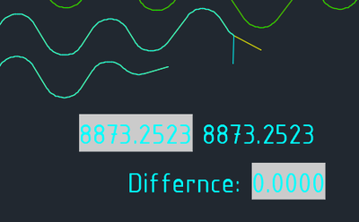

if we are working with polylines we need to know the legth of it. For that I want to create a program which can make these three Mtexts.
I want to have three Mtext:
- Current length of polyline in attributive - Program from Lee Mac can do it
- Original length of polyline as normal Mtext - I can do it
- The Difference if the length changed
The program Area Field LISP by Lee Mac can create an attributive text which shows the length the polyline if it changed after a regen it shows the new length.
I've modified this program, I let simple run it and with entlast I can reach this text, take the content and create a simple Mtext with the length of the polyline in position1, which is not changing, it always shows the original length.
But I need a third attributive text with the difference in position2.
Can here someone help me with it?
I want to get something like this:
On the top is the part of the code what I created.
I simple added the whole program from Lee Mac - I know the half of it I could delete because the are part is not needed only the length part.

(defun c:lf_extended ( / e ed text position position1 position2)
   (lengthfield nil "%lu6")
   (setq e    (entlast)
	 ed   (entget e)
	 text (cdr (assoc 1 ed))
	 position (cdr (assoc 10 ed))
	 position1 (polar position 0 30); Position for Mtext not associative
	 position2 (polar position (/ pi -2) 7); Position for Difference Mtext associative
   (command "Mtext" position1 "_none" "@" (text) "")
   (command "Mtext" position2 "_none" "@" (strcat "Difference: " text) "")
)		    ;end

2,964 Views
ВeekeeCZ
btw where is the test dwg file? I scrolled the page all the way down, could not see it. I don't believe you did not post it,... it's probably just me who could not find it.
eakos1
Hello,  is it really necessary in this case?  You juts draw a simple straight polyline and thats it. If it works here it is fine.
But anyway, I'll post it.
eakos1
Here is the sample file.
And I found a failure in my code - two unnecessary brackets between the "text".
(command "Mtext" position1 "_none" "@" (text)"")
ВeekeeCZ
Ok, I'll just post this example that I did some time ago. There should be all you need for your case.
And yes, it's always better to post an example. It makes things easier for us.
eakos1
Hello, thanks for this file.
I could manage with the help this routine my program - it works fine now. 🙂
Here is the code if someone interested in:
;;; This program based on the program from Z9E3zK5E from https://forums.autodesk.com/
;;; Creates Mtext for the length of the selected objects:
;;; - 1. current length - associative

eakos1
Finally I used up just your code not the program from Lee Mac.
Thanks again.
