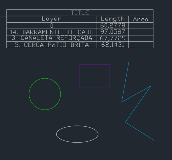

Hi. I would like to add a fourth column (at the beginning of the table), with a solid hatch with the layer color of the selected object.
Message 9 of 11
eng.cmagalhaes
Community Visitor
Community Visitor
Hi, I've just intalled lisp and apparentally it's working correctly but the area information (numbers) it's not appering on the AREA row. I would ask you please to check if the code is suit able for AutoCAD 2019 version. Thank you very much.
Message 10 of 11
dlanorh
If you read post 4 the area column is for hatch objects
I am not one of the robots you're looking for
Message 11 of 11
javier.longueira
Hi! Excuse me for my poor english.. If possible add filter (or column) by global width plines (width by pline, no by layer)???
