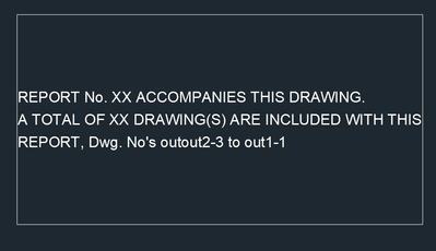

Our layouts are typically labelled as A2_1234-1 to A2_1234-100 (that's only an example)
We have text in our drawings as below
REPORT No. XX ACCOMPANIES THIS DRAWING.
A TOTAL OF XX DRAWING(S) ARE INCLUDED WITH THIS
REPORT, Dwg. No's XXXX-1 TO -3
I want to change the XXXX-1 to the first layout name and the -3 to the last layout name, but if the layouts change I want the references to update as well.
eg. XXXX-1 TO -3 becomes 1234-1 to 1234-100. Yes I know the A2 bit is missing I just want to get it started first before I start fiddling with removing characters.
and if the 1234 changes to 5678 the text will become 5678-1 to 5678-100 (with a regen)
EDIT: I forgot to mention this text is in model space and in shown in each layout via a viewport

Message 6 of 20
h_s_walker
@DGCSCAD Unfortunately I get a error bad function when I run your lisp
@Moshe-A Unfortunately your lisp will not run. Can you make it LT friendly or is that not possible?

DGCSCAD
Just a heads -up: The order of (layoutlist) changes each time a layout is renamed.
Type (layoutlist) at the command line and note the order.
Rename any Layout and then type (layoutlist) at the command line again to see.

DGCSCAD
I did find this: https://forums.autodesk.com/t5/visual-lisp-autolisp-and-general/layout-order/td-p/3749964
(defun Layorder (/ order)(vl-load-com)
      (vlax-for
             lay (vla-get-layouts (vla-get-ActiveDocument (vlax-get-acad-object)))
            (setq order (cons
                              (list (vla-get-name lay)
                                    (vla-get-taborder lay))
                              order
      (mapcar 'car (Cdr (vl-sort order '(lambda (j k)
                        (< (cadr j) (cadr k))
Comparison after running the above:
Command: LAYORDER
("1235-1" "1234-2" "1234-3" "1234-4" "1234-5")
Command:
Command: (layoutlist)
("1234-2" "1234-3" "1234-4" "1234-5" "1235-1")
Run the Layorder function, then apply the same CAR and LAST calls to that list instead of using (layoutlist).

h_s_walker
@DGCSCAD That looks like it could be very helpful
I shall give it a test
Yep that worked cheers.
