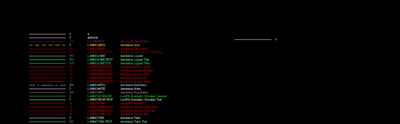

Thanks for this code! It's been very helpful. I'm still trying to finagle a little something extra thrown in. I've amended it to print line-color-layer-description, and I though I could amend it further to add linetype between color and layer, but it's not working out. Instead it only prints the first line and the first color code. LayList is on the left and LayList - Test is on the right in the below screenshot.
I'm very new to this kind of coding, so I'm feeling pretty lost on what I'm doing wrong. I really want to use this to map out new plot styles for my office so I can visually compare them to existing styles. Any thoughts?
Thanks so much in advance!
Message 8 of 8
paullimapa
there's additional code to get the linetype name.
try replacing in your laylisttest.lsp code under your laylistsub function this line:
    (if (/= 0 (strlen (setq desln (getpropertyvalue (tblobjname "layer" ln) "Linetype"))))
with this line:
    (if (/= 0 (strlen (setq desln (getpropertyvalue (getpropertyvalue (tblobjname "layer" ln) "LinetypeObjectId") "Name"))))
