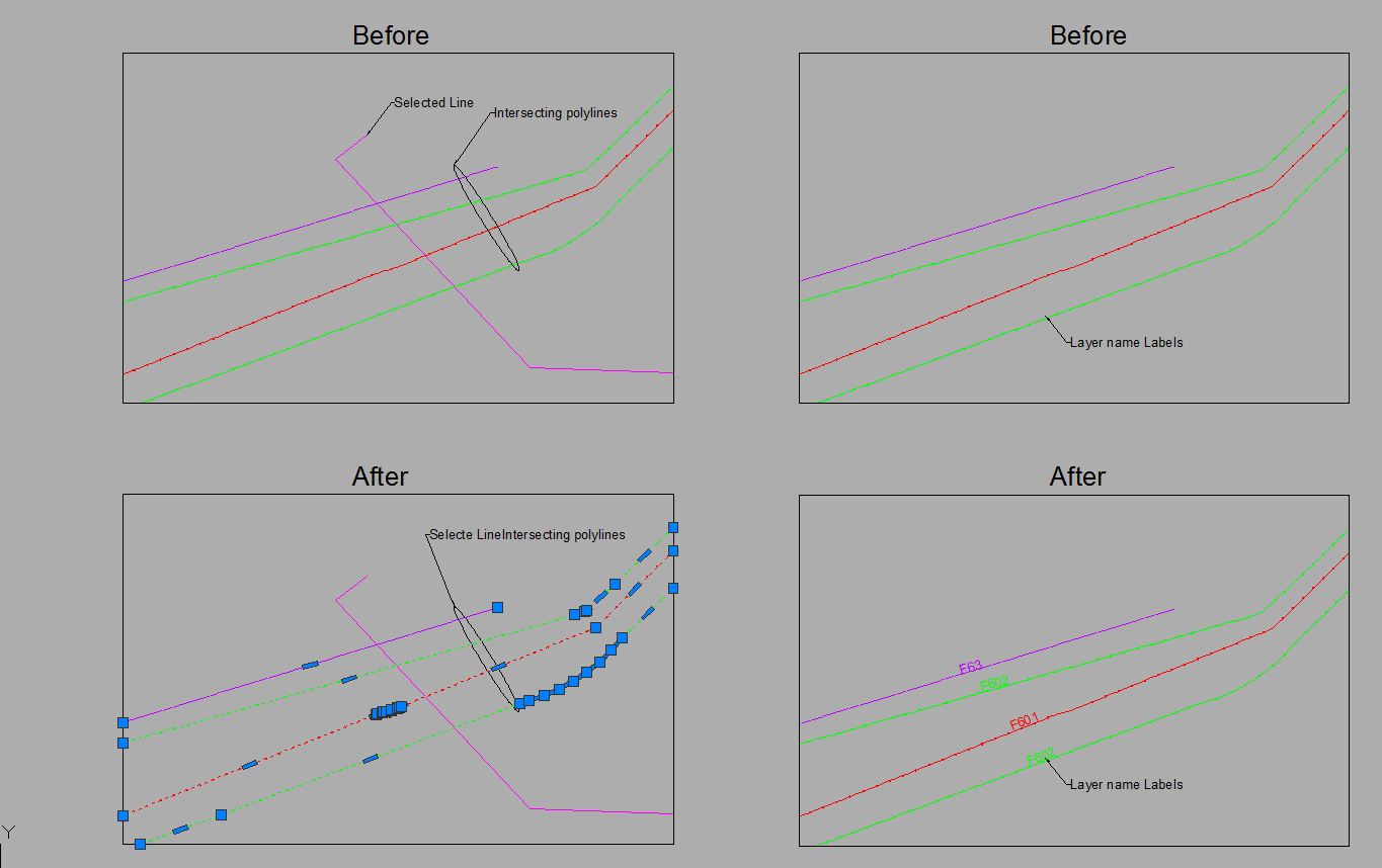

Can any body help me in this causes ,
I want to select all polylines (or all entities Etc.) which is intersecting to selected Polyline,
And the Other thing is that
I want to Place a layer Name Lable on the Polyline with the same layer name Like Polyline layer should be lable layer name is this can be happen with multiple selection
For this any Lisp is there.
2,493 Views
13 Replies
Replies (13)
Message 2 of 14
SeeMSixty7
Can you upload an image of before and after of what you are looking for?
Good luck,
Message 3 of 14
Hannan1
Message 4 of 14
Hannan1
Please check Before and After Screenshort Capture 2 file name attachedCapture 2.JPG
