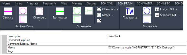

When we setup the Ribbon a few years ago I wanted the block’s to come into the drawing to the scale I was working in, 1:100 or 1:200 etc….
So the cannoscale set 1:100 the block was coming in at 1.
1:200 = 2
1:50 = 0.5
Etc…
So adding the insert_to_scale worked but now its not.
With the change from AutoCAD 2016 to AutoCAD 2018 & 2020 a command in the ribbon doesn’t work.
This worked fine with AutoCAD 2016.
Now when we go to insert the Blocks etc.. from the ribbon to the scale of the drawing scale it doesn’t work now.
I get this error.
error: no function definition: INSERT_TO_SCALE
Do you know how to fix it?
Refer image for the ribbon and the macro.
