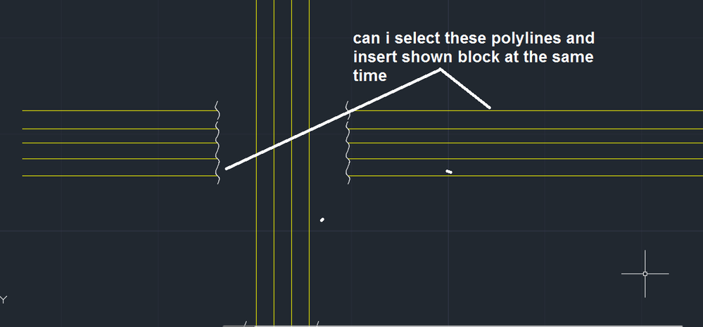

eng_mohamedmustafa
i want to select polylines seen in the attached photo ... and insert the block that appeared in the photo

Kent1Cooper
I think that could be done IF  you are willing to restrict your selection method(s) to only  either picking individually or with Fence selection [not, for example, with a Crossing window], in both cases closer to the end where you want the Block.  You could combine those methods, for example using two Fence selections, one on either side, or selecting some by Fence and some by individual pick, in the same command.
With those selection methods, AutoLisp is capable of knowing at what point each object was selected, either the individual pick point or where the Fence crossed it, and therefore would be able to decide at which end of it to put the Block.  It can't do that with Crossing-window selection, or regular Window, or CP or CW or Lasso or Last or Previous.

ВeekeeCZ
@eng_mohamedmustafa wrote:
this is another lisp that insert block at the end point of polyline i choose ... i want to edit this to choose multiple point to insert multi blocks (the same block) at the same time )
You're not listening, not reading. You're totally missing the point. It's about to figure out an ALGORITHM of how to make it MULTIPLE!!! All the rest is easy.

 Not sure how about the blue part. You might want to comment that out.
Try this [lightly tested, and without the usual enhancements yet]:
