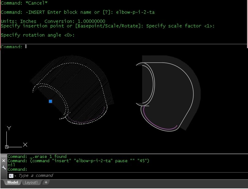

I'ld like to insert a block with a given point and rotated towards another point.
but what are the prompts autocad needs?
(command "insert" Blockname insertpoint "" "" rotatepoint)
This doesn't seem to work for me...
Can anyone tell me if I'm missing a prompt or if I'm giving too much data to the "insert"-command?
Where can I find these for other commands (eg. Command "circle" needs a insert point and distance)
Thanks in advance!

Message 2 of 10
Shneuph
Hello.  Welcome to the forums!
A good start is just to complete the task manually.  Then go back and look at what you had to input into the command line.  That is what needs to go into your (command ...) lisp code as well.
(command "insert" "elbow-p-i-2-ta" pause "" "45")
Pause allows the user to pick the insertion point. "" is like an <Enter>
It looks like what you have is close.  Is it giving an error message?  What is in the command line after you try to run it?

Make sure cmdecho is set to 1 if not already.  It can help give more prompts to figure out what the problem may be.
If these are the block names try passing them to the insert command as a string.
e.g. (command "insert" "Langsprofiel_links_zijkant" pt_lp1 "" CENTERPOINT)
If the block is (A in the drawing already or (B in the support file search path.  If not, you will need to supply the full path to the file
e.g. (command "insert" "C:\\CAD\\Blocks\\angsprofiel_links_zijkant")
Instead of running the full lisp try manually setting values for pt_lp1 and CENTERPOINT.  Then just work with the (command "insert" ...) line until you get that syntax correct.

Message 10 of 10
That did the trick!
Blockname had to be between "    "
+ I had to add an extra pair of "" to fill up a prompt.
thanks! I think I can handle it a bit further from here on out!
