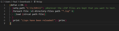

I am a noob and therefore do all my LISP in Notepad++. I reload the functions with a short function that re-loads all my lisp routines. For example
(defun c:hh ()
	(setq path "C:\\LISPs\\") ;Wherever the LISP files are kept that you want to test.
	(foreach file (vl-directory-files path "*.lsp" 1)
		(load (strcat path file))
	(print "Lisps have been reloaded!") (princ)
In AutoCAD, I'd type "hh " wait for them to finish loading, then type whatever LISP I was testing. Usually that is "test" or whatever.

I just copy & paste your code into Visual Studio Code and right away you see a number of benefits like how everything is color coded and being able to check for matching parenthesis really help with coding:

@paullimapa Yeah, I have NotePad++ do the same thing. It will also give suggestions for functions as you type. VSC does that too with an addon but I also have NotePadd++ doing it with custom made functions including giving information what the function does and what inputs it needs. I was working on trying to get VSC to do the same but I couldn't figure it out and gave up. That was like 2+ years ago though.
Unfortunately, highlighting of parentheses only happens when you click on them. But here is an example of it giving info for one of my custom functions along with highlighting.
