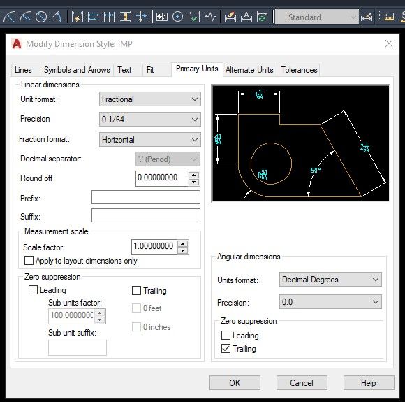

I've been trying for a while to remove trailing zeros in dialog boxes, because I think it looks cleaner and makes edits easier (no need to select a whole block of zeros before typing a new value). Here is how I did it.
My length units are typically set to maximum precision:
Which means that my dialog boxes have tons of trailing zeros:

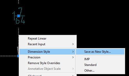

However, create a fractional dimension in the drawing, right click and save it as a new dimension style and...

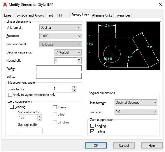

There will be no trailing zeros in text fields! You can then set the dimension unit format to whatever you like (decimal with three places for me):

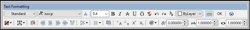

As long as the "no trailing zeros" dimension style is active, it suppresses trailing zeros in the text formatting bar (except for the slant/spacing/stretch options, but I don't use these often), the multileader style settings and the table style settings:
