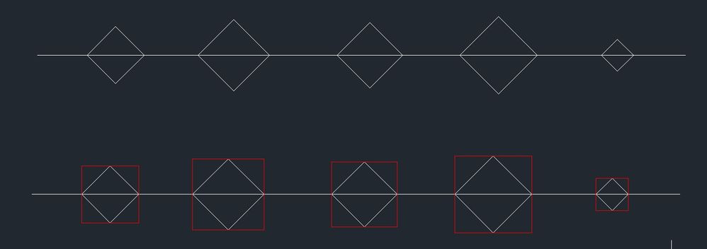

Hey everyone, I'm in trouble again
This LISP is a square made of two triangles
Can achieve the effect of drawing two points into a rectangle
But the rectangle is not in the positive direction
Can this LISP be changed to a rectangle in the positive direction?
Above the photo is the LISP effect
I want the effect of red below

After you've drawn the rotated white square, then do the following:
(setq en(entlast)) ; select last object
(setq ob(vlax-ename->vla-object en)) ; convert to vla object
(vla-getboundingbox ob 'mn 'mx) ; get coordinates of object's bounding box
(setq llpt (vlax-safearray->list mn)) ; convert to lower left coordinate point
(setq urpt (vlax-safearray->list mx)) ; convert to upper right coordinate point
(command"_.Rectang" llpt urpt) ; draw the square

a22663564
It is successful, but the original rectangle is not needed, can it be deleted?

I would not do it by drawing the diagonal box, then finding its bounding box, then drawing the box you want [EDIT: if it is really the box you want -- see my next Message], then deleting the diagonal one.  I would do it directly:
(defun C:SQR (/ ANG12 ANG1X ANG2X P1 P2)
  (setq p1 (getpoint "\nfirst point :"))
  (setq p2 (getpoint p1 "\nsecond point :"))
  (setq
    ang12   (angle p1 p2)
    ang2x   (+ ang12 (/ pi 2))
    ang1x   (- ang12 (/ pi 2))
    rad (/ (distance p1 p2) 2)
  (vl-cmdf "line" p1 p2 ""); if still desired
  (vl-cmdf "pline"
    (polar p1 ang1x rad) (polar p2 ang1x rad)
    (polar p2 ang2x rad) (polar p1 ang2x rad)
    "_close"
That's in simplest terms as yours is, but I would suggest adding control over Object Snap, at least, and other typical enhancements.
It looks from the end of your video as though maybe you don't want the Line across the middle, but I wasn't sure.

... if the two points are in an orthogonal relationship to one another, but not if they are at some other angle:
My routine in Message 7 works at any angle [as does your original that draws the diagonal box]:
Kent Cooper, AIA

Yes, paulli's LISP will not work in other angles will not make positive angles
But the LISP you all changed all gave me very good results, thank you very much
Need to cross the middle line he is necessary
Because of the effect of the product
That is, the rectangle of the blank part of the dotted line needs to be broken
But CNC programming to process many small straight lines is too troublesome to process
So choose to draw a long straight line first and then let the rectangular part break it
So a straight line that will pass in the middle is needed
But if the result last can be overkill and pe , it will be more perfect
Because of the multiple small line segments, I will finally do OVERKILL and PE to make it a straight line
In this way, CNC programming is more convenient
