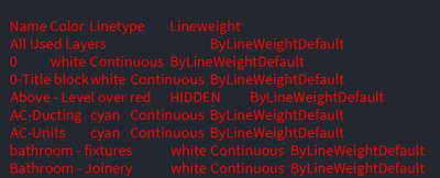

Open your layer command palette.
select ALL (CTRL+A)
CTRL+C
then CTRL+V into modelspace or whatever other application window you want to use.
Done.

Hi Pendean,
Thanks for this. so it does copy them all as 1 text but as one layer too. Is there a way to have them in individual colours/layers?
Tom
(will take a look at the lee-mac link)
