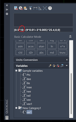

One option is to use quickcalc. Set a constant then use it in an expression.  For example,  in the following I've defines a constant named  var1 and set it to 10.
When typing the expression for a point star with a square bracket. The "10" you see in the expression below was entered by double clicking var1 uder New Category.
After hitting Enter you get the following:
You can copy/paste the result of the calculation;  7.667,0 into the prompt line.
