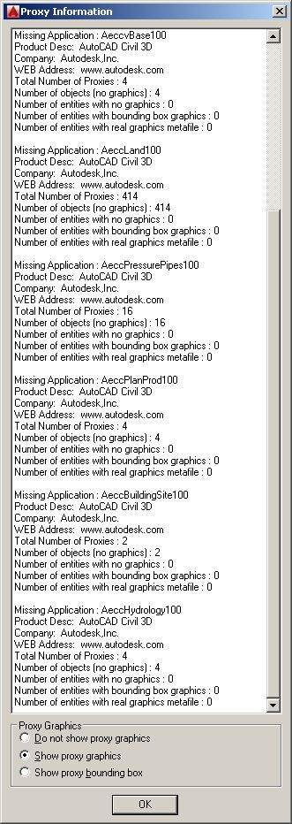

I'd like to go through a bunch of drawings that we received and create a list of all of the missing object enablers.
The proxy information dialog box provides this information but I'd like to batch process a set of drawings and save the information to a file.  This way I can find all the OE's that are needed and deploy them to the users who will be working on the drawings.

Here’s the issue:
We’re running AutoCAD 2017 which is set to save to 2010 format since many of our clients are still using older versions of AutoCAD.
PROXYNOTICE is set to 1 (Proxy warning is displayed) so users see the proxy information dialog when they open the drawing.
Every time they save the drawing they get the version conflict message:
PROXYSHOW is set to 1 (display graphics)
PROXYGRAPHICS  is set to 1 (Saves image with the drawing)
I figured that I’d roll out the missing OE’s which should then eliminate these messages.  It would also allow users to see any additional metadata attached to custom entities with graphics.  Users also want the metadata available in Navisworks so it needs the OE's too.
I’m seeing a lot of drawings that have Civil3D proxy objects (no graphics).  I’ve also seen a few of them that had text callouts which would not display unless I installed the Civil3D OE, even though AutoCAD was set to show proxy objects.
Other drawings are looking for other OE’s such as Plant 3d, AutoCAD Mech, ProStructure, CADWorx, etc.
I seem to remember that at one time there was a setting that would allow AutoCAD to automatically download and install the OE’s as needed but that no longer appears to be an option and could be a security risk.
Any other ideas?
Thanks Tim

Wow.  I just finished testing the Civil 3D 2017 OE and you are 100% correct.
It adds the proxies no matter what you do.  All you have to do is open a drawing with the OE installed and save it.  It will from that point on have the Civil 3D "zombie" proxies.  At least that explains why they're showing up in P&ID drawings.

I tested the Civil 3D and Plant3D object enablers and both of them have issues...
Civil 3D 2017 Object Enabler
The Civil 3D 2017 Object Enabler is adding unwanted proxy objects when you open and save drawings in AutoCAD 2017 SP1 when the enabler is active.
Steps to reproduce:
1. Verify that PROXYNOTICE is set to 1 (proxy warning is displayed) in AutoCAD 2017.
2. Create a new blank drawing (I used the OOTB acad.dwt) on a PC that has only AutoCAD 2017 SP1 installed (no OE), save the drawing and close it.
3. Open the new drawing on the same PC. Note that the Proxy Information dialog is not shown since the drawing has no proxy objects in it. Close the drawing.
4. Open a drawing with Civil 3D objects in it on the PC with the OE installed and close it (do not close AutoCAD).
5. Open the new drawing on the same PC.
6. Don't make any changes, simply save the drawing and close it.
7. Open the drawing on the PC that has only AutoCAD 2017 SP1 installed.
8. The Proxy Information dialog is displayed which shows the proxy objects that the OE has added to the drawing.
The issue only occurs if the OE has been “activated” by opening a drawing with Civil 3D objects. If you restart AutoCAD on the PC with the OE and repeat steps 2 and 3 above, the issue does not occur.
Autodesk support has confirmed that this is a defect and has escalated this issue to the development team (the defect ID is CIVIL-18430).  At this time there is no way to "batch remove" the proxy objects.
