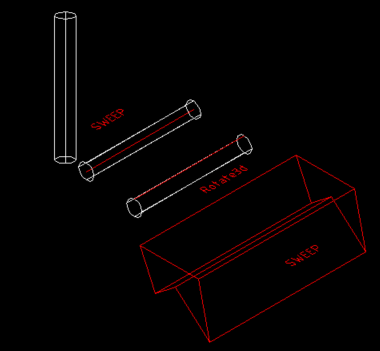

I am using the MSWEEP AutoLISP routine from this Autodesk post:
How to sweep solid along multiple paths in AutoCAD
The routine works fine for sweeping a solid along multiple paths, but I would like to modify it to add a Base Point option, similar to the standard AutoCAD SWEEP command.
I would like to be able to select a base point on the profile before selecting the paths, so that the profile is positioned correctly when it is swept.
Does anyone know what needs to be added or changed in the LISP code to make this possible?
Thanks!
146 Views
Sea-Haven
If you look at the sweep options one of them is Base point. if you just pick object and then Sweep it looks like it just uses a centroid of object, so you may need to add that option in the lisp. The other way is to use Rotate3d about a control point so orientation is maintained then use extrude. Just be aware using base point need to draw object in correct orientation.
Base point of object in image is the "V"

LeoManu
Sorry for the delay. I just tested the LISP and it works well, but I have one issue.
I attached an example. When I run MSWEEP on a W profile (rotated vertically from the top), on some lines it creates the sweep below the path (which is what I want), but on other lines it creates it above the path.
Why does this happen?
Other than that, it works great! Thank you very much for your help.

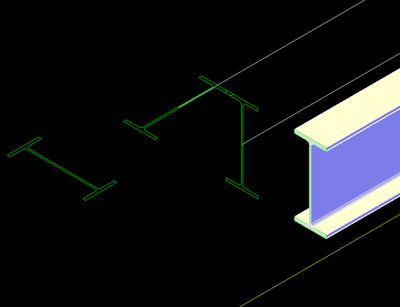

Sea-Haven
As I suggested earlier for me I would tend to use the rotate3d function, you take a shape place on the start of the path, then stand it up vertically and rotate to be at 90 degrees to the path. This is an example take shape drawn in World, rotate to align with path, move based on correct base point, I used m2p picked center of flanges, then end of path, rotate3d so stand shape vertical, then did Extrude using path. It could be a lisp.
Thought straight away lines or plines on angle but flat no 3d. For say UB would get mid point flanges, then mid top and get angle, then realign to match angle of line etc and stand up vertical.
This is line only as a test if happy will add more objects, The paths can be at angles.
