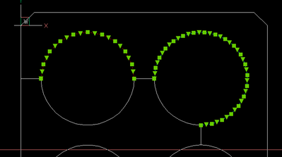

I was digging forum but couldn't find anything, I am sorry if someone asked before
How can I know that how many objects are there in polyline, (how many line, how many arc etc)
for example, there are 5 line and 1 arc in this polyline.
Thanks in advance.
Since we haven't yet seen any response to suggestions to date, I will raise further questions:
What do you mean by "know"?  Do you just want the information reported at the command line as in most suggestions so far?  Or drawn in as text, similar to your image, and if so, do you want the segments labeled/numbered, or is all that just for illustration of what you mean by quantities of each segment type?  Or are you looking for something more elaborate such as the table in the routine at the link in Message 4?  Put into a spreadsheet or text file?  Something else?
And what is "etc" [whatever that is, if anything, not being shown in your image]?  Details such as in that routine linked in Message 4?  Or do you really only want the number of line and arc segments, with actually no "etc" required?
3D Polylines?  [They can only be of all line segments.]
Would you want something [though not quantity of line and arc segments] reported about Fit- or Spline-curved "heavy" 2D ones?  What about "heavy" ones that are only of ordinary line and arc segments but just happen to be "heavy" instead of "lightweight" [the result would need to be arrived at differently]?

hello, I have a cnc styrofoam cutting device, I need to convert my drawings to gcode for this device, normally I can only convert drawings containing lines, but I could not create the code when there was a circle or arc in the part, I did not give too much information here because I only wanted to get the information I needed. I like to do the work myself, and I don't like to have someone else do my own work,
I think it is not nice to write here and ask people for help when needed without doing any research.
Thank you to everyone who helped with the issue.

I have added sample drawing and gcode which belong to this drawing.
I want to create this gcode via lisp.
Message 14 of 19
