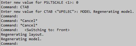

I'm new to LISP and can't figure this out. This is basically a copy-and-paste LISP I threw together because I don't know how to write them from scratch. It's supposed to end in model space, but it doesn't:
(defun C:LINEFIX ()
(command "LTSCALE" 48)
(foreach lay (layoutlist)(command "_LAYOUT" "_Set" lay "PSLTSCALE" 0))
(command "_LAYOUT" "_Set" "MODEL")
(princ)
After the last layout tab PSLTSCALE is updated to 0 it runs the layout command, but for some reason ends up switching to a layout instead of staying in model space. See attached command line screenshot. I've tried using tilemode but couldn't get that to work either.
Just not my area of expertise and need some help. I'm sure it's an easy fix.

Try this one.
(defun C:LINEFIX ()
   (foreach lay (layoutlist) (command "_LAYOUT" "_Set" lay "PSLTSCALE" 0))
   (setvar "CTAB" "MODEL")
   (princ)

Or even better, remove all the commands and just use setvar
(defun C:LINEFIX ()
   (setvar "LTSCALE" 48)
      (setvar "CTAB" lay)
      (setvar "PSLTSCALE" 0)
   (princ)
Message 4 of 18

The routine seems to run fine in AutoCAD Vanilla in which I tested.
What are you using?
Plain AutoCAD Vanilla or an AutoCAD vertical like ie Plant 3D or Architecture?
Message 7 of 18
peterjwinberg
Still ends up in a paper space layout 😞
Maybe it's a bug in my system.

Just checked in AutoCAD 2014 (I only have 2014, 2016 & 2017 installed) but no errors and I end up in Model even if another layout is active when running the command.
Are there any active reactors that may switch to a predefined layout?
If you type (vlr-reactors) on the command line, does it return anything other than nil?
Message 10 of 18

Mmhhh....strange.
I've tested your drawing in AutoCAD 2014 & 2017 with your LISP and everything seems to be working fine. All variables are being set and the Model tab is activated without any problems or messages.
However, when opening the drawing I got a message regarding a proxy object regarding an app VisionREZ from a company Ameri-CAD.
Any change you have this running on your system in AutoCAD and this is program is the cause of automatically switching between Model and a Paperspace layout?

Although the *cancel* lines in your screenshot suggest there is something running in the background of AutoCAD that messes up the switching to model. But what it is will remain a mystery for now I guess.
