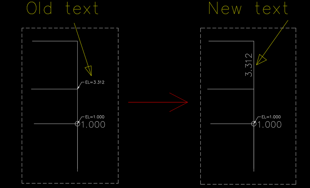

Hi all , I has lisp But I want to help Change  Rotate text In position as in the picture and want to remove Arrow
Please Help

ВeekeeCZ
Maybe like this.

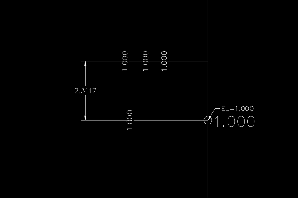

chan230984
@ВeekeeCZ
Not right
ВeekeeCZ
I see..

      (entmakex (list (cons 0 "TEXT")
			(cons 10  p1)
			(cons 11  p1)
			(cons 40 (getvar 'textsize))
			(cons 50 (/ pi 2))
			(cons 71 0)
			(cons 72 1)
		      (cons 73 1)
			(cons 1 (rtos level 2 3))))
      (while (setq p1 (getpoint "\nSpecify next level position: "))
			(cons 10  p1)
			(cons 11  p1)
			(cons 50 (/ pi 2))
			(cons 71 0)
			(cons 72 1)
			(cons 73 1)
			(cons 1 (rtos (+ level (- (cadr p1) (cadr p0))) 2 3))))
