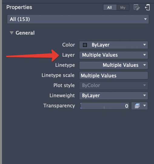

I don't see the problem with your three images. The last image has a blank layer setting because the selected objects are on different layers, not that the layer doesn't exist. If you select objects one by one you will see that a few objects are on layers other than 0.  To get the most control, just select the layer you want those nested entities on, presumably layer 0.

If selected objects are on different layers. Properties palette on Mac shows:
There is a bug in LAYMGR command on Mac: when layer you want to remove from drawing is inside on of blocks, then the objects that were on that layer inside block simply loose Layer name information - it become blank.
As the result you even cannot copy such objects to clipboard and it is necessary to run AUDIT command in order to repair this. After auditing objects with empty layer name placed to $AUDIT-BAD-LAYER layer.
