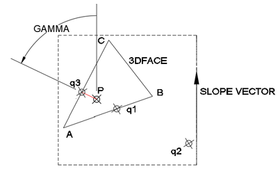

I’m a bit late with a response but I’ve been tied up with other activities. The geometry challenge interested me so I thought I’d give it a try. There are two major tasks to address:
   1. Determine the line on a 3dface that starts at a specified point on the 3dface,has a specified slope and ends at the uphill edge f the 3dface.
  2. Determine the series of lines that define a path across an array of 3dfaces that have a specified slope.
I decided to tackle task 1 first. If the maximum slope of a 3dface is greater than the design slope there are two possible lines that meet requirement.  The program below creates the line for task 1. The slope vector is the cross product of the face normal with the result of the cross product of the face normal and the z axis. A vector with a slope equal to the design slope but with an XY direction of the slope vector is rotated by an angle gamma about the z axis to get a vector in the correct direction for the task. Three intersections points (q1, q2, and q3) are determined and are defined by a line passing through p and in the direction of the solution vector with the three sides of the face. Points that are not on a line segment of the 3dface, or are not at a higher z value than p, or are not coincident with p are eliminated leaving one valid solution point.
In the example below q3 satisfies the three requirements.
Here's a plan view showing the angle gamma.  Note that q2 is on line infinite line BC but not on the edge of the 3dface.
If the sign of gamma is negative then we have the solution below.
q1 is on a line passing through line AB.  q2 is the solution from p.
With a valid method for determining the design slope line the next challenge is task #2. Once a point Q is determined that lies on a edge of a 3dface, a brute force method can be used to search through the array of 3dfaces until one is found that has point q on an edge. A new point Q is calculated and the search is continued until no solution is found. To speed the search of very large collections of 3ds faces it might be beneficial to sort the 3dfaces into sub-groups. Each sub-group would only contain 3dfaces within a rectangular boundary. A search for a 3dface with a known value of Qx, Qy on an edge would only look at the group where the coordinates are within the minimum and maximum x and y coordinates for that group.
Run the program slopeLine then select a 3dface, specify a slope and then specify a point within the boundary of the 3dface or along one of its edges.

The direction of the slope vector and the direction of the required maximum slope (I call it the design slope) can be directly calculated. It is not necessary to use a numerical solution (i.e., trial and error).
As I note in post #42, the slope vector is the cross product of the face normal with the result of the cross product of the face normal and the z axis. In LISP we have:
(setq slopeVector (unitvec (cross Normal (cross Normal '(0 0 1)))))
Where unitvec makes it a unit vector.
We can create a vector at the design angle under the slope vector as shown in red in the image below.
We want to rotate this vector about the z axis by an angle gamma that will make it flush with the plane of the 3dface. This angle is:
(setq gamma (acos (/ designSlope slopeFace)))
where slopeFace is:
		(setq slopeFace
		       (/ (caddr slopeVector)
			  (distance '(0 0 0)
				    (list (car slopeVector) (cadr slopeVector) 0.0)
This is one solution that yields the green design slope vector. The other solution is to rotate the slope vector by an angle of minus gamma. Programmatically you can set it up to either always take the “+” or “-“option.
Knowing point P (the start point) and the design slope vector that lies on the face plane, point Q , the exit point (your point M) can be determined by calculating the three intersection points of the lines defined by P and the Deign Slope vector with the infinite lines defined by the three sides of the 3dface.
Try out my code from post #42 on a single 3Dface.
I’m in the middle of writing the code to create PQ lines for a group of 3dfaces. I was going to search the list of faces looking for a face that has point Q on its edge but I like your approach of using “… SSGET with a crossing option to select entities crossing points M and X…” to find the two adjacent faces. I’ll look into that approach.
Note, in my previous post I incorrectly showed the slope vector for the negative gamma solution.  Hoefully the following will help to clarify the angle gamma.
Lee

@autoid374ceb4990
I've got some promising results for calculating a path of a specified slope along a collection of 3dfaces. It is still a work-in-progress however.
To focus on the slope line calculation I've kept the user input requiring the following:
1. User specified slope, the default is 20%
2. The start point must be on the edge of a 3dface (use osnap nearest).
3. The user must select the 3dface that has the point on its edge.
The program does not terminate gracefully.  Note that P is the beginning point on the edge of a face and Q the departing point.  Q is used to find the next 3dface to work with.  The main problem now is finding a reliable process for identifying the two adjacent faces at Q. I tried several configurations of using ssget "_c" to find the two faces that are adjacent at Q.  Just using Q twice as you suggested sometimes works.  I had better luck with two points (lower left, upper right) as with this code. I'm not sure if it helps or hurts to use 2D rather than 3D points.
(setq Q2D (list (car Q) (cadr Q)))
(setq pLL (mapcar '- Q2D '(0.005 0.005 )))
(setq pUR (mapcar '+ Q2D '(0.005 0.005 )))
(setq ss (ssget "_c" pLL  pUR '((0 . "3dface"   ))))
It occasionally fails.  When a selection set was not created  the program creates a small circle at Q and outputs "No selection at Q."
The program does not create a single 3dpoly.  I found it better for debugging reasons to just create lines with this version.
Here's a sample of constant slope paths that were created on your LIDAR drawing.

Just draw the 1st line as a pline then as you add a line just use pedit join (entlast) via the lisp. Or add each entity name to a list then use join at end.
Message 60 of 90
autoid374ceb4990
@leeminardi
I tried out the program you posted in post #58 and it works very well, with the few exceptions you mentioned.
I was trying to enter a design slope of 0.02 (2%) and I noticed that your code would always default to 0.2 (20%), so I changed the input for that variable.
As far as creating a POLYLINE, what I have done in my 'C' code is write each point to a file as they are created, and when the the program ends, read the points in the file to create the pline. Don't know if that is feasible in LISP???
