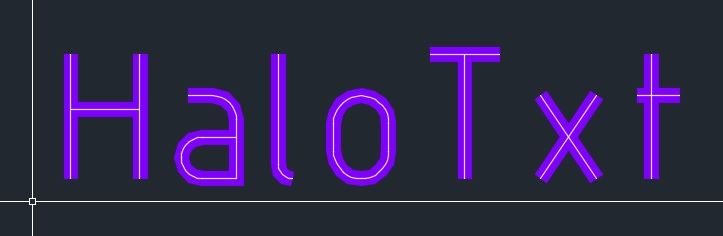

Why do all those steps?
With the entire thing you get: (note the missing parts near the cursor)
And the above is what you get with just an export & import of wmf data
Message 24 of 46

Ok. This should work, but still not perfect. Most of the times it's good, but not with each font.
as you can see here:
Some of the lines on the right side did not get the global width assigned. If i do it by hand, it's ok.

@simon.connellRBKGZ I finally have some time to spare again for the coming weeks, so I'm definately going to spend some on this as I said I would, AND add the ability to (properly) process SHX fonts as well.
In reply to @jmartt & posted here since this might be interesting for others too:
As there's no constraint with the original [edit:txtHalo.lsp] (it doesn't check if the selected text uses TTF, or not) I checked to see what it does (using standard values like a 2.5 font hight & default linewheight). The result was pretty much what I expected. Only parts of the text actually got 'haloed', due to the fact that there's no character 'outline'.
The method used basically comes down to: Exporting the text as a 'vector graphic' & import the resulting polyline's. Which in case of a TTF (which always has a certain thickness to each character) results in an 'outline' of each character. But in case of a SHX font, there's usually only the thin center line (which you assign a line width, to give the characters body).
So, I might have to come up with a slightly different approach to make it work for SHX fonts.
Message 40 of 46
roland.r71
@jmartt, as for the shx fonts halo...
 Will this do?
