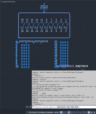

Hi everyone!
I am working on a LISP routine to auto-align multiple attributes in a single row in a block, so that when a user has filled out the attributes, they can then run my LISP routine to auto-align the text so that it doesn't overlap.
I have successfully created lists of the attributes I need and now am coding the alignment part.  Basically, I want to call JUSTIFYTEXT middle right on the leftmost attribute,  JUSTIFYTEXT middle left on the second attribute, get the Alignment X-coordinate of the leftmost attribute, set the Alignment X-coordinate of the second attribute equal to that of the leftmost attribute, and repeat this down the chain, setting the justifications for each attribute back to their original values when I'm finished.
However, the program gives me an ADS request error at the line below, where I try to grab the "AlignmentPoint/X" of an attribute so that I can manipulate it later.
(setq coordNumber (getpropertyvalue (nth inc delimList) coordName))
I have verified through print statements that ...
-  coordName is the string "AlignmentPoint/X" (without the quotations)
- inc is 0
- The first value in delimList is the entity name of the attribute I want.  I verified this by calling getpropertyvalue on the entity name to see the Tag.
I then ran the dumpallproperties command on the entity name of the attribute, and I think my problem is that the AlignmentPoint values aren't reading through for some reason.  I pasted the whole property dump below if that helps, but the AlignmentPoint values all say "Failed to get value".  Can I not access the AlignmentPoint values if the attribute is within a block?  If so, I don't know if I can accomplish what I want to do.

Thanks for the quick reply!  I am working on the top block in the attached drawing (AutoCAD Electrical, though I don't think that matters here) and will hopefully have time to test this tonight or tomorrow.  However, see an update below ...
I realized last night that I might be trying to do the wrong thing by moving the attributes themselves, because I will have multiple of this same block on one drawing, each with have different attribute values.  What I think I actually want to do is the equivalent of the screenshot below: select the block, grab the grip points of each attribute, and **STRETCH** the attributes to move them so that they don't overlap.  This doesn't appear to affect the position of the attributes in the block itself when I explode the block.
In the screenshot below, it would mean keeping the "20" where it is and adjusting the other four overlapping attributes so that they align and don't overlap, like I did for the attributes in line "1".  Obviously, I can space out the attributes better in the block, but the WIRENO attributes in particular will have widely varying lengths so the alignment will never be quite right on its own.  And I don't want the user to have to go down each line grabbing grip points because there will be a lot of these blocks in the design, so I was hoping to find a way to do this in LISP.

Ok ran into a little problem, the tag SEPARxx is at the end of the attribute definition, rather than being in the order viewed. It may have been an oversight when making the block. It adds a big bit of overhead into the get all the values. So I was going along real fast have tagname, textstring, physical length of tetxstring and so on, will have to think about a different way to get values. Just for future reference when playing with large amounts of attributes the order of the attributes can be quite critical to make lisp tasks simple. You could just reorder the attributes using Bedit and Battman which has a push attribute up in list.
What is needed is a lisp put attribute 32 to position 4 and move rest down. I was at one stage looking at whether can do a vlax-put blk 'attributes "new order of attributes" may have another go at that.

Ok took a new approach and found something I was looking for. If you run this code on your sample dwg you will reorder the attributes list, it will not change there   display position but puts the SEPARX atts in correct location when filling details.
From a coding perspective makes your task so much easier as atts are in order.
Can you please try it and comment back if ok to use the new dwg.
