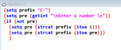

Bonjour @dvertz
oops! When editing my post, some answers were posted. I’m not fast enough!
I am not sure to understand correctly your question.
I propose that if press “return” at the prompt without giving an answer, you concatenate the prefix and the number 1.
Amicalement
Éternel débutant.. my site for learning : Programmer dans AutoCAD
DA
