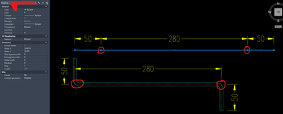

Here I am again, guys!
I need a routine that takes a plate and creates a continuos line based on the centerline of a polyline or its vertex (the easiest option) as you can see in the example bellow. Can someone please help me or at least guide me in the process? Thank you in advance!

I think a print screen would do a better explanation...
1-Select the plate (closed polyline)
2-Create a centerline with radius zero
3-Draw a polyline with the segments lengths based on centerline
Message 15 of 22

Message 16 of 22
Kent1Cooper
So now that I see your image, I just want to clarify:  You don't want a result like this?
If that's the case, the manual approach I suggested before would need to include FILLETing the center-path Polyline with Zero radius before SPSing it.  But I think the same questions would apply.
