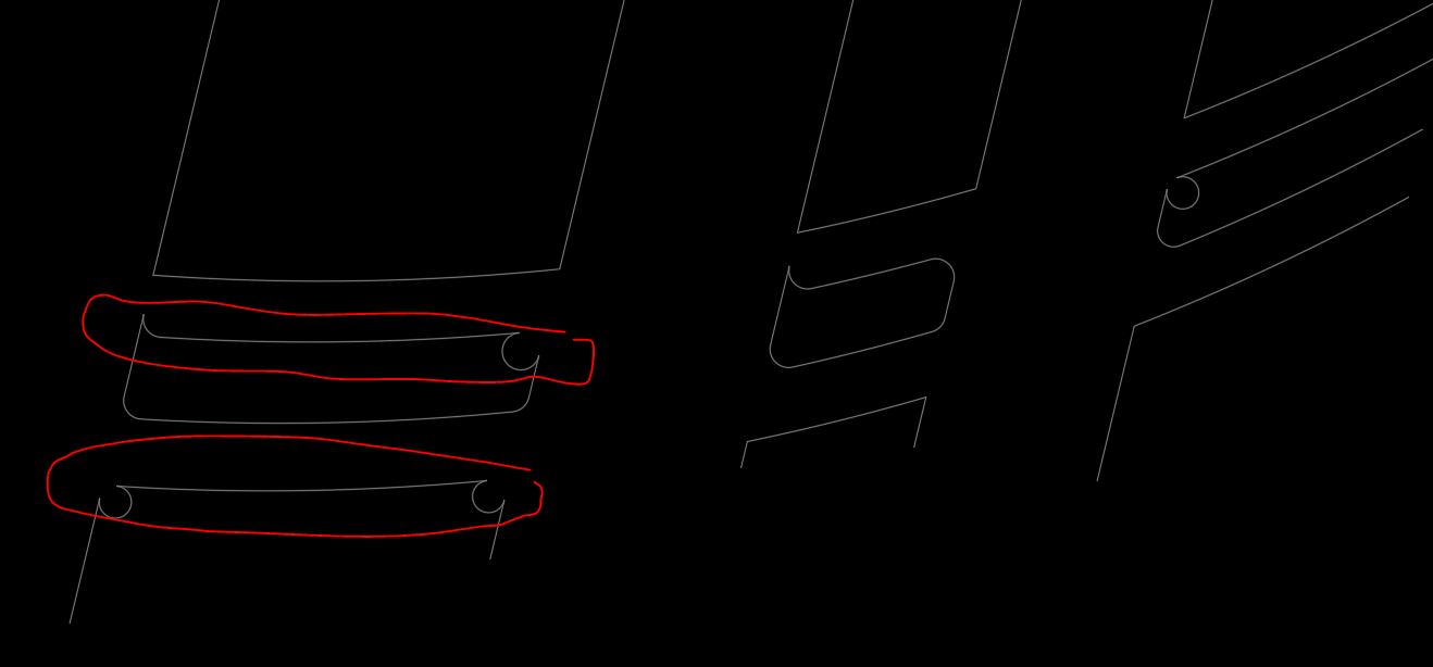

Hi all,
I am trying fillet multi pline after joint line and arc. But fillet error. Some pline not fillet and some pline fillet reverse arc. Can anyone tell me the way fix it.

I am trying same photo attached.
Message 6 of 19
dmfrazier
It looks like it worked. So, what's the issue?

From the pics you've posted, it looks like you might be doing some trimming and (perhaps) filleting and (perhaps) joining before getting the undesirable results from (perhaps) further filleting of already-filleted lines and/or (perhaps) polylines.
I think at this point it might help to have a copy of a DWG and a step-by-step description or demo of exactly the procedure you go through which gives you the undesirable result.

One potential problem is that your "closed" Polylines are not closed, but merely end at the same place they start [5 vertices for a 4-sided shape], which certainly can cause problems in some operations.  I tried Trimming out from the Lines/Arcs originals, and connecting into Polylines using PEDIT/Join, and I got the same result.  I tried again using JOIN, and they at least came out actually closed, but the same weird things happened at corners.  When I built my own  closed 4-sided Polyline with two opposite line segments and two opposite arc segments, Filleting worked fine.  Your original parts all seem to be in the same plane, which is one thing I wondered about [but maybe not if you go way down in decimal places? -- I didn't check that].  I don't have anything else to suggest for now....

Yes, you right for pline: 5 vexter and 4 segment. But i trying draw pline 4 vertex and 4 segment (draw by hand or boundary) then still error return. Pls see attached file.
