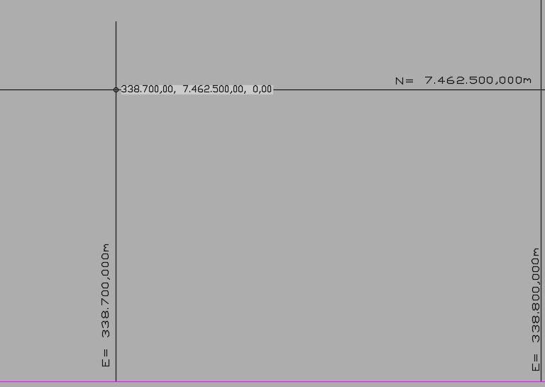

I have a function that add's an Mtext to a block that refers to a field with the insertion coordinates. This works fine in WCS.
However is there a way to control the field so the UCS coordinates of the block are used (like using function trans) instead of WCS ?

You can use a formula instead of Position property of the block. In the formula field you can use any function available for CAL function.
For Ucs transformation, the function is W2U(p). So you will have a Formula containing the function W2U. For the point, insert another field in the formula, select the object and pick Position property.
See the attachement for example.

Hi
In my sample above, the block contain 2 attributes, one for WCS point and one for UCS point.
Edit the attribute and double click on the field.
For the WCS, in the dialog box check only the component you want (X, Y or Z)
For the UCS, use one of the following function: rxof for X component, ryof for Y or rzof for Z. Now the formula should look like:  rxof(w2u(x, y, z))

phanaem
Hi
You can use a mix of simple texts and fields for the attribute value.
It can be like this: UCS = [field_x], [field_y]
[field_x] is like: rxof(w2u([field_position]))
[field_y] is like: ryof(w2u([field_position]))
