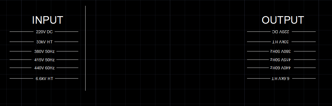

Dear Helpers,
I gota lisp code that can explode selected line types, But the output text is getting mirroring. Please see attachments.
I need the exploded text as it is by using the new lisp code. Thank you in advance.

Message 5 of 8
Hi Sir,
It's almost reached except moving of all lines to other location and text rotation is falling at 180 degrees.
Please have look on attached image and dwg.
